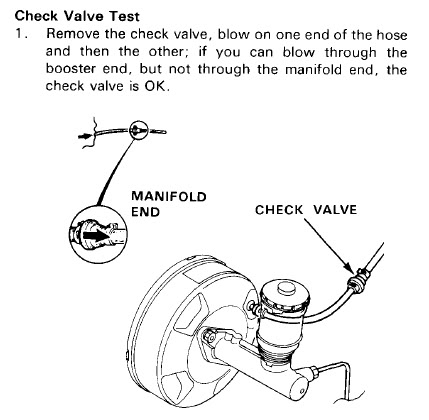

I have some new symptoms; Managed to get it started today and got it to idle but it would die as soon as i but the brake on (in neutral and not moving). I'm going to guess that's a vacuum problem?
Old Feb 9, 2009 | 05:26 PM
Maybe a bad brake booster check valve:

I've changed my mind. It dies if i turn on the headlights or put on the brakes even if i have it revved at 3k. So I'm thinking alternator now. I'll test the checkvalve tomorrow when its light out.
