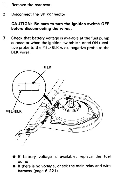

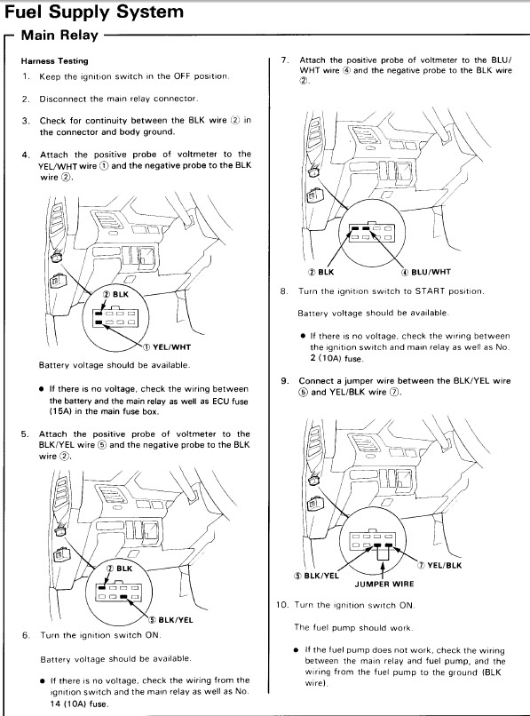

Old Apr 12, 2009 | 07:13 PM
Here's how to troubleshoot:

i'll test it when i can thanks for the info i'll keep on posting till i figure it out
