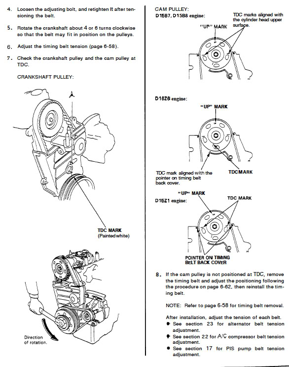

Did the cam and crank perfectly align at TDC1 as shown in the diagram below? Note that the pointer on the lower timing belt cover should align with the lone white mark separated from the group of three marks on the crank pulley.
If all is fine, then it's time to measure cylinder compressions. Click link in my signature.

yeah all four plugs are good, I'll re-check the timing. I did do a compression test, I forgot to mention that. 90, 110, 90, and 110 were the measurements. And no CEL that I noticed... I appreciate all your help btw
