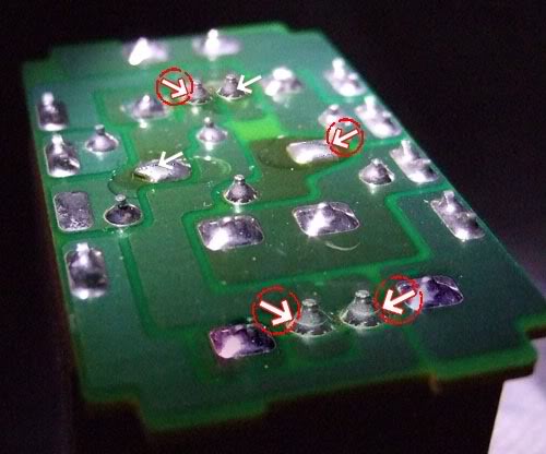

either replace your main fuel relay or open it up and resolder the bad spots on it.
