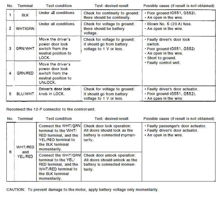

Do all power locks not work or just some?
Have you checked whether fuse 6 under the dash is blown?
Here's how to pinpoint the problem:

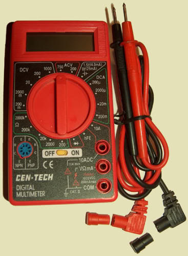

ok, bringing back a old thread but i dont give a shizz. so i finally bought a digital multimeter (leaning over to unlock all the doors gets annoying) to try and solve my door lock situation. None of the door locks works with the switch. doesnt make a sound or anything when i hit the switch. i tried another switch and still dont work.
this is the multimeter that i bought, but the damn thing didnt come with instructions on what the displays mean and how to check for certain things. (harbor freight).
what icon do i choose to test for what ronj posted. thanks alot.

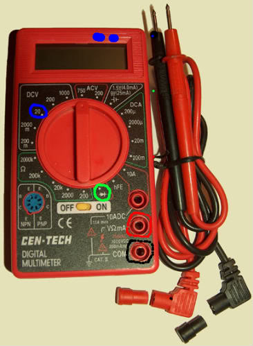

Old Jan 27, 2010 | 10:27 AM
You should be able to download an online instruction manual for the meter.
Plug red meter probe into hole circled in red.
Plug black meter probe into hole circled in black.
To measure voltage, turn meter dial to position circled in blue.
To measure continuity, turn meter dial to position circled in green. The multimeter may make a beep sound to indicate continuity.

Old Jan 27, 2010 | 10:43 AM
Dipsetcivic117's Avatar
Joined: Apr 2008
Posts: 826
From: City of Champs
ahh. now i see what i did wrong. i had connected the red meter probe into the top slot, and not the middle one. thanks alot ronj.
Old Jan 29, 2010 | 07:22 AM
Joined: Apr 2008
Posts: 826
so im guessing i have a broken wire. when i did the first test, there was continuity. when i did the second test, there was no voltage at all. the fuse is good because i took it from the power window fuse, which was working before. i stopped at test 3 because there was still no volts from the battery. so theres a broken wire somewhere, and its hard to find it. im guessing it might be in the bundle that always fold when opening and closing the door.
Old Jan 29, 2010 | 07:47 AM
mk378's Avatar
Posts: 10,023
Yes the wires tend to break there. Find the white and green wire on the car side of the door and push the meter probe through the insulation to check if it is live there. If it is, splice in a new wire across the part that folds, with the splices at places that don't move. The wire going through the hinge area will probably still look OK but the copper is broken inside.
Disconnect the battery before working on the wire because it is always live.
