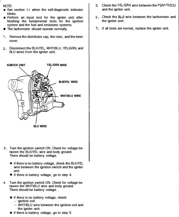

Given that the specific problem appears to be lack of spark and that the distributor has already been replaced, then I recommend that the igniter input tests shown in the diagram below be done when there's no spark at the plugs.
