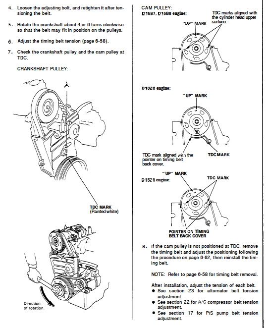

I'm a little skeptical about it being the timing belt since the car never stranded me.
Here's what you would be looking for with respect to perfect timing belt synchrony at TDC for the cam and shaft:
