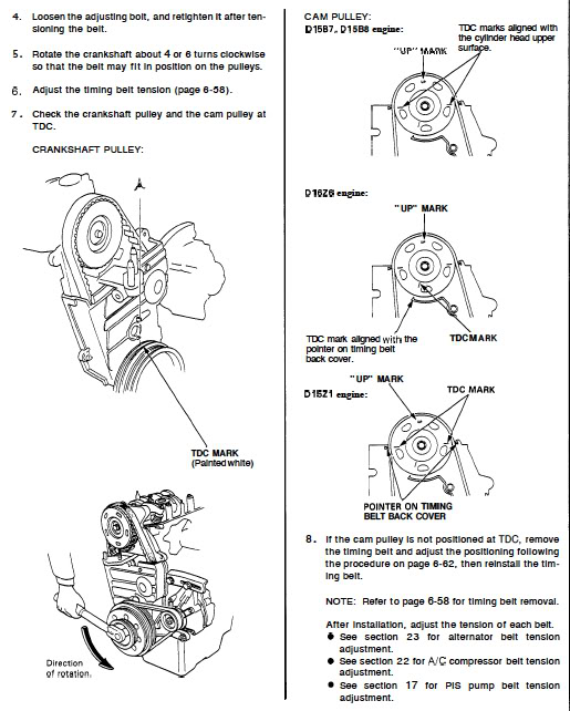

The timing belt may have skipped a tooth or two. Here's what the mechanical timing should look like if it's fine:

Checked the timing position, it appears when set to TDC that the rotor does point to the number one plug. Hopefully that means the timing belt hasn't slipped.
