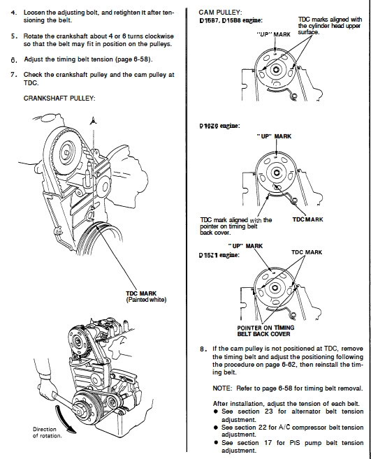

dammit...my manual clearly shows the inspection window is located on the front of the engine, where the block and the gearbox bellhousing meet...but i cant find it. I need to locate to determine tdc. 94 civic cx, is it in a differnet spot or am i on glue?
Old Jan 21, 2009 | 09:58 PM
To check the cam timing, you need to remove the valve cover and then the upper timing belt cover. TDC1 for the cam gear is when the arrow points UP and the two side marks align with the top of the head (view the latter from the distributor side of the cam gear). TDC1 for the crankshaft pulley is when the pointer on the lower timing belt cover aligns with the lone white mark separated from the group of three marks on the edge of the pulley.

OK... I think I got it now. My haynes manual was misinforming me. To verify crankshaft pulley is at TDC1 i need to access indicator from timing belt side of motor, so wheel comes off, and splash guard, i'll pop off the inspection plug and index crankshaft to tdc1. If camshaft pully marks are horizontal then mechanical timing is good. Its late and i need to get a 18mm 1/2" drive socket to proceed. Saga continues tomorrow. Thx RonJ

in order to check the crankshaft is at TDC, i need to line up the markings that are on the crankshaft pulley itself to the timing belt cover markings. So without accesssing from the wheelwell, how do I get a line of sight too see the markings line up?

I think the splash guard has an access hole through which the crankshaft pulley bolt can be turned with a wrench. If correct, then removal of the splash guard and wheel are not required, though it might give you more access to the bolt. With the front end on stands, this is the only part of the procedure that is done from below the engine. Note: Only turn the crank pulley counterclockwise as you face the pulley.
TDC1 for the crankshaft pulley and camshaft gear are done from above:

allright, so the mechanical timing is good. With crankshaft pulley at tdc1, the cam gear marks are horizontal (line up with the head) and the "top" mark is up. Rotor points to Cylinder 1.
