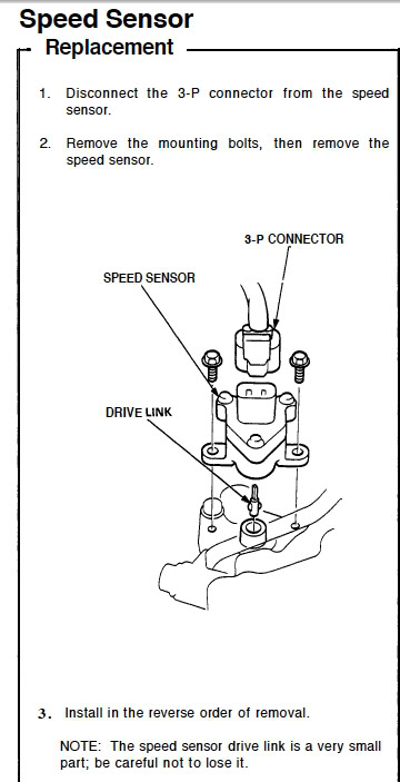

where is the VSS? and how can I get to it?
Old Jan 24, 2009 | 11:23 AM
Located on top of transmission:
