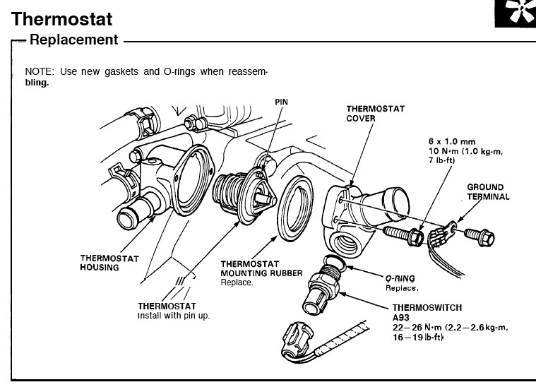

The thermostat is easy and inexpensive to replace yourself.
You would need to do some electrical troubleshooting work yourself to know whether the ECU really is the culprit (see pgs 11-88 to 11-89 of the 92-95 Civic service manual at link in my signature). Did the dealer provide any additional details about the ECU problem?

Default RE: 95 Civic Ex Coupe 2dr A/C problem
Sorry, the diagram that I posted is the thermostat for the cooling system not the A/C system. The A/C thermostat is attached to the evaporator under the passenger side dash (see pgs 22-21 and 22-22 of the manual). Start by testing whether replacing only the A/C thermostat fixes the problem.
Yes, the PCM is the same as the ECM/ECU.
