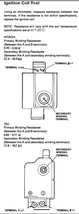

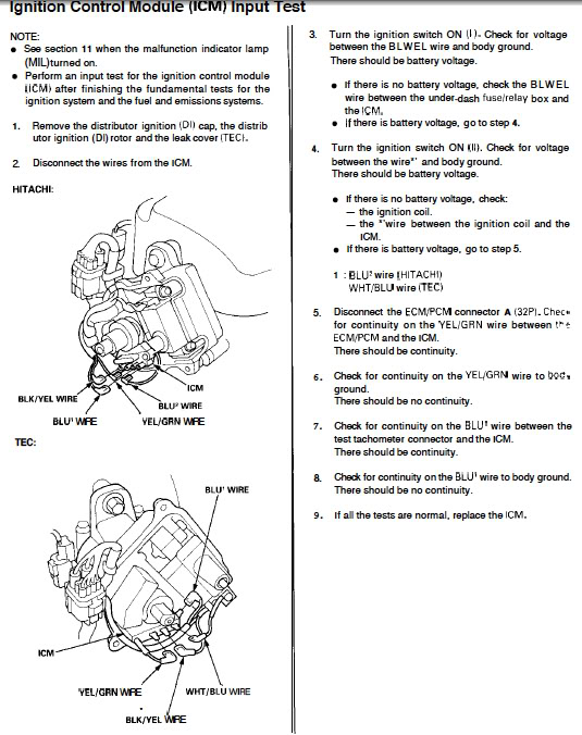

Sometimes pulling the plug wires can damage the coil. Here are some tests for the distributor and coil:
Old May 18, 2008 | 07:00 PM
civicmania's Avatar
Joined: May 2008
Posts: 4
Default RE: 95 vtec
Thanks, great technical info what manual is that from? will make those checks tomorrow.I did check rotor button its ok.no spark at all at spring from coil. thanks again really appreciate the help!
