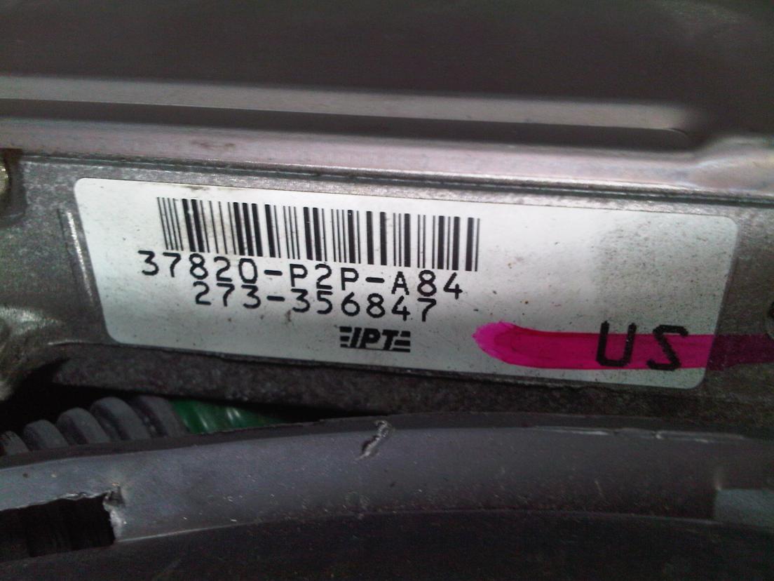

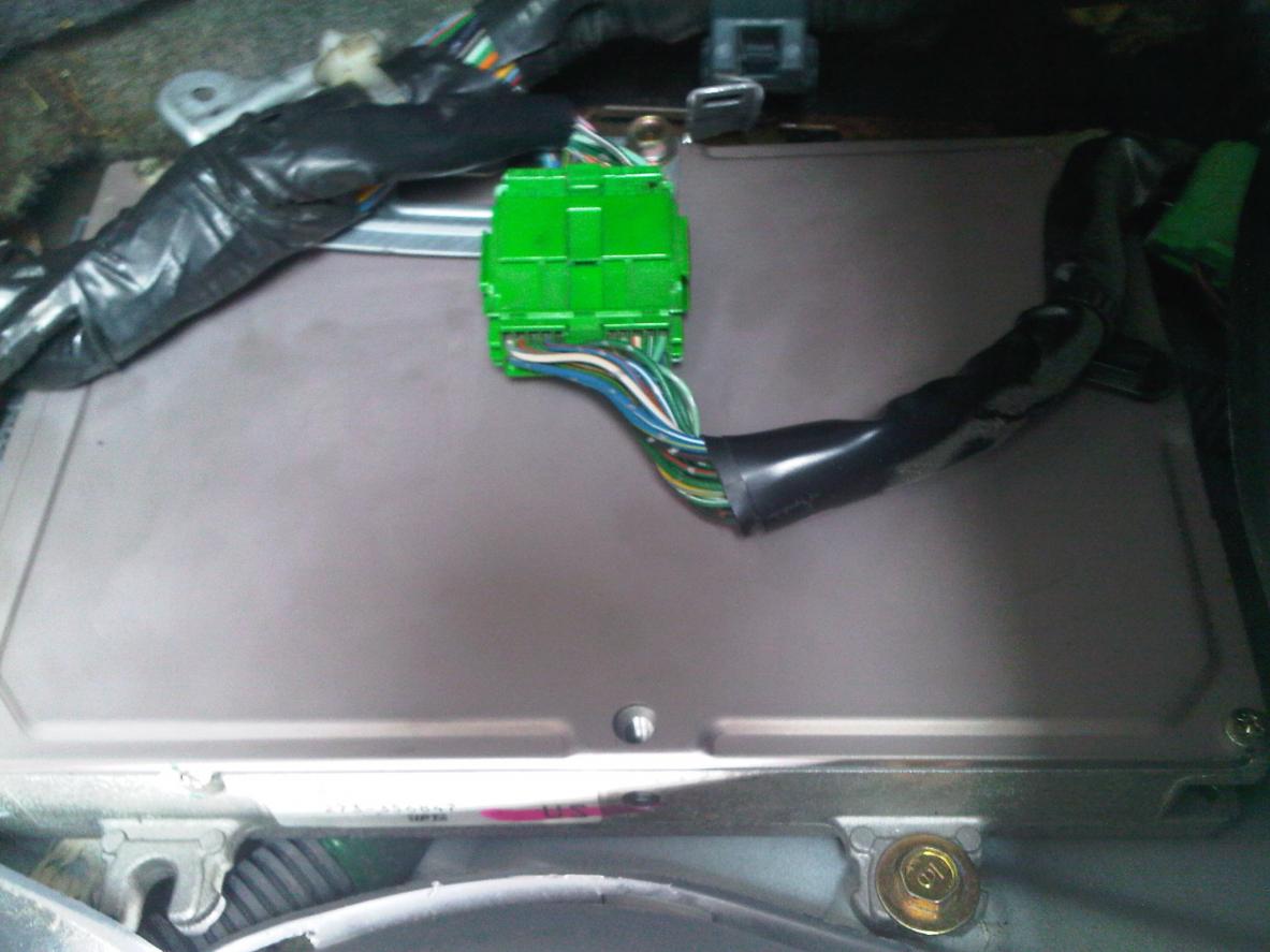

You might want to figure out what ECU is being used. It's behind the passenger kick panel. Post a picture. You need an ECU for an automatic transmission because one for a manual transmission will create problems.

here are the pics ..........the d4 comes on for a sec and then shuts off is that what ur asking?
