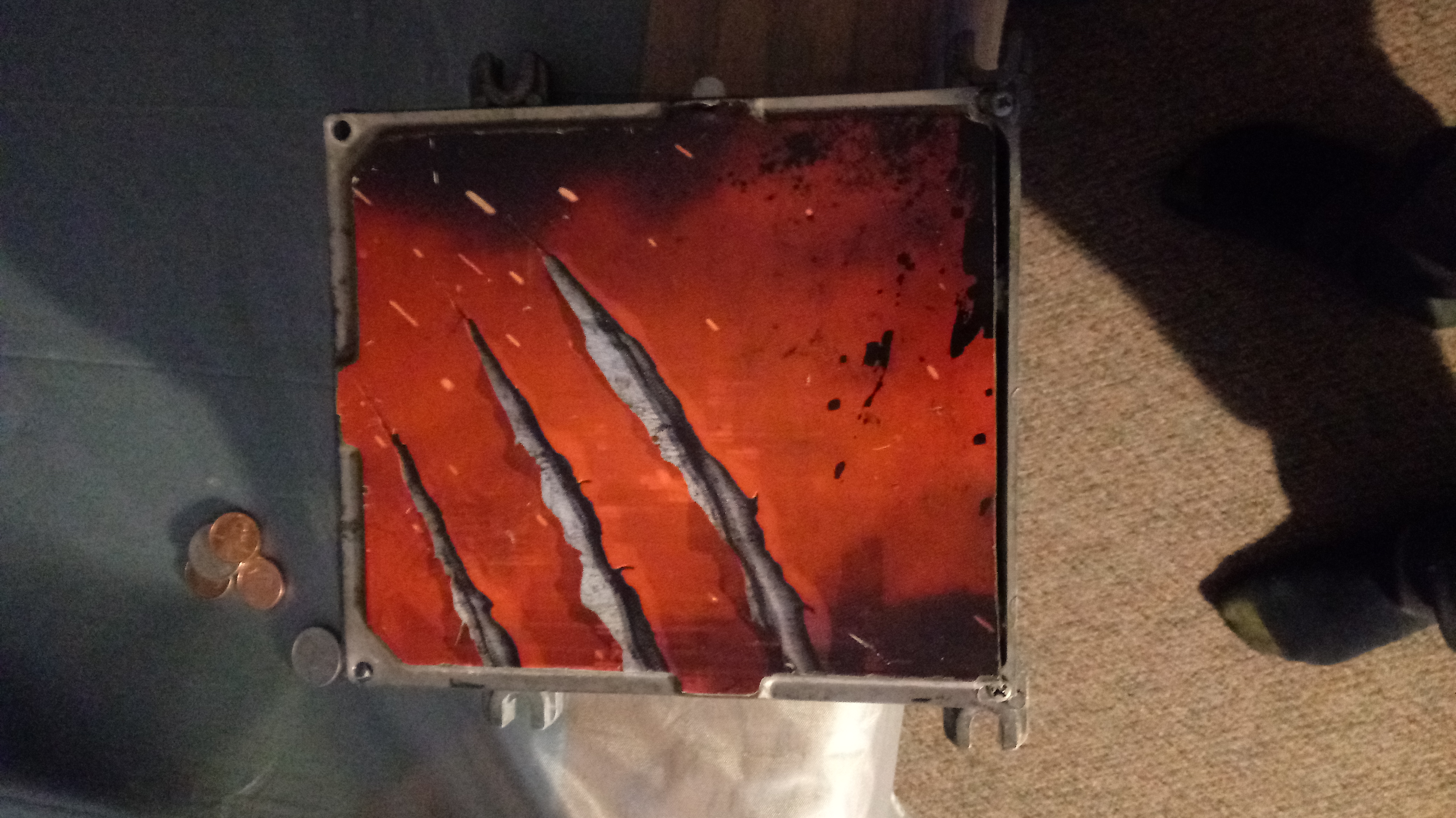

This is the pic of both the cover and the numbers... the sticker is on both sides of the ecu very perfectly cut.
it seams as if the owner purchased the ecu like this, i cant imagine a reason why someone would waste the time to put that image on both sides of the ecu just to stuff it in a kick panel and also perfectly cut it to fit.. seams like a company did it to me... but i couldn't find a brand online that does that image.. car was bought in Chicago if that helps jar a memory... any help would be great.. im about to buy something off ebay that claims to tune ecus per bolt-ons...

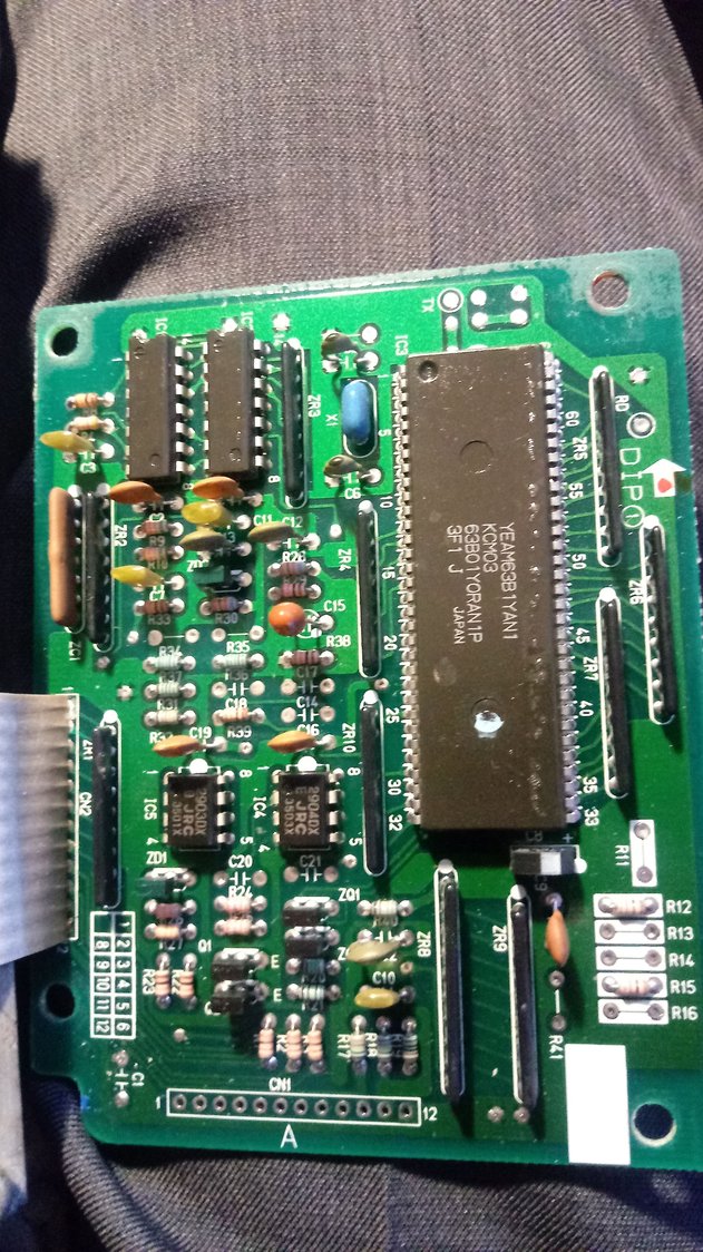

Small Board
Bottom of Small Board

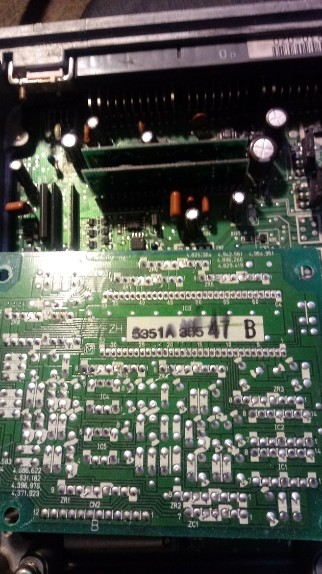

Whole ECU

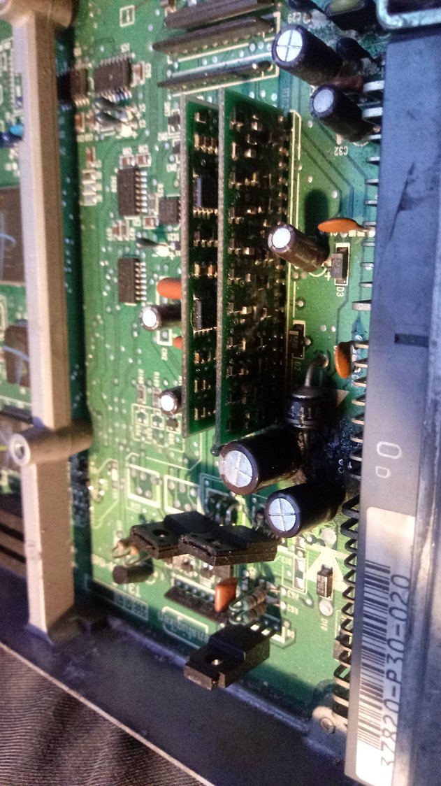

Area That Blew Up

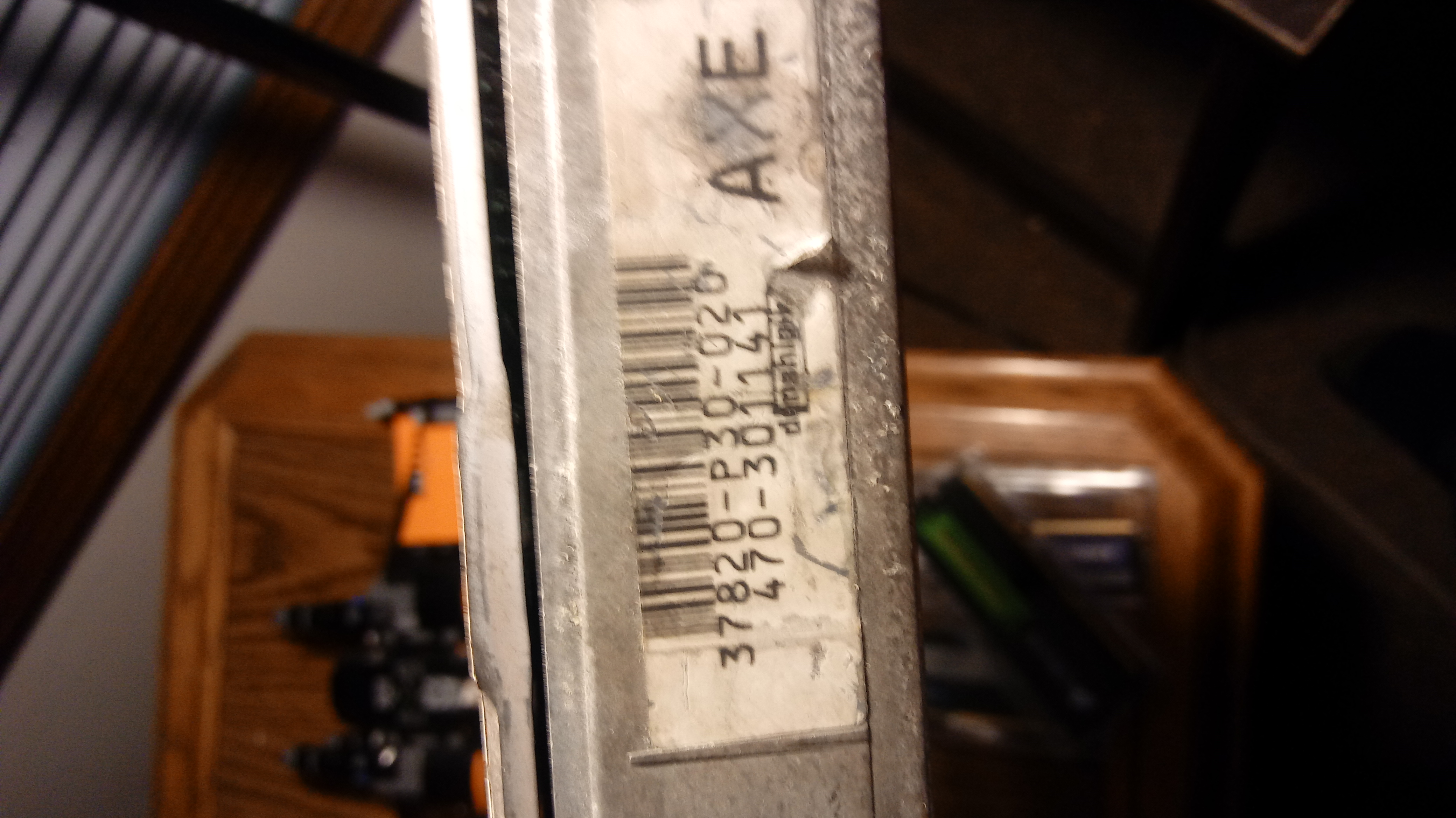

Hopefully this is enough for someone to help me.. its a P30 ecu

Looks like a stock P30, which is an ECU for a JDM B16. I could be wrong about that engine though.

P30 jdm ecu
Yes I do have a conversion harness going into the ECU. I did a bunch of digging and it is indeed a jdm p30 which is for the b16, any idea why he would have this ECU instead of one for a b18? It has an aftermarket intake manifold which I read is a must for a b18 to work with this ECU.. I just don't get why not just use a teg ECU to begin with. I am assuming this ECU isn't tuned, there is no socket installed for a chip so I am leaning toward just getting another jdm p30 and being done with it. Car runs really great, I would have never guessed it was using a b16 ECU.. Vtech engages really aggressively, not sure red line, I always shift at 8k.. Would you agree this looks totally stock? I think I'm going to buy an ECU I found, its the same one, virgin, and not to salty.. Would I get better performance from a teg ECU? I don't want to make a mistake buying an ECU, they are pretty pricey..
