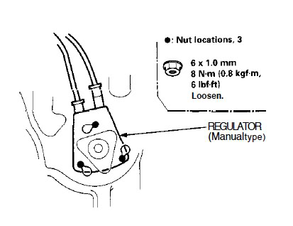

Is the problem actually with the handle cable mechanism?

Old Feb 1, 2009 | 08:32 AM
so is that seperate from the window regulator?
Old Feb 1, 2009 | 08:39 AM
You're right. It's part of the window regulator. Remove the window glass from the door and check for binding of the regulator when rolled all the way up and down. If so, you need a new regulator. You may be able to pick up a used one from a salvage yard.
