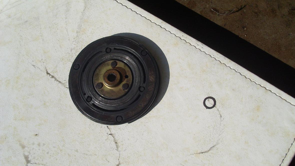

Im goint to try and bring back an old thread, Im sure my clutch is the prob because when the a/c does not work the cluch is not spinning. BUT it will if I tap it with a piece of metal. From what I have read I need to remove a shim and maybe clean the clutch? My car is a 98 ex coupe, can I do it without removing the compressor?

Well I think I fixed my problem. I did a bit of searching and I turned up that I had to remove a shim from the clutch to my compressor. The coil is trying to pull the clutch in but because of the added gap it does not always work. I rented a clutch removal tool from autozone and removed the clutch. I did not have to remove the compressor to do this on my 98 civic ex. To get to the bolt I had to remove the motor mount. Once removed I only had one shim between the compressor and clutch. I removed it and cleaned both clutch and compressor surfaces with carb cleaner. I did put blue thread lock because I read it was common for the clutch to just fall off. Tried to find the tourqe specs but could not find. When bolt is torqued make sure the clutch spins freely. You also have to check the gap with a feeler gauge which should be between 0.014-0.026 inches. Hopefully this will hold up for a long time. BUT MY QUESTION NOW IS DOES THE COMPRESSOR HAVE TO HAVE A SHIM. SHOULD I LOOK FOR A THINNER ONE OR CAN I RUM MY COMORESSOR WITH OUT ONE. If someone can please answer this I would appreciate it so I can start driving the car cause I dont want to mess it up if it needs a shim

You can run with no shim, as long as the clutch doesn't rattle or drag when off. Once the clutch is worn some you need to take shims out (possibly all of them) to compensate for wear.

When it is not cooling, pull over and open the hood (leave the engine running and the A/C button pressed). Confirm the radiator fans are both running and the compressor not engaged. If that is the case, read post #25 about taking the shims out. ("New" compressors are also sometimes set up with too large a gap.) If the compressor is engaged but no cooling there is a different problem.
