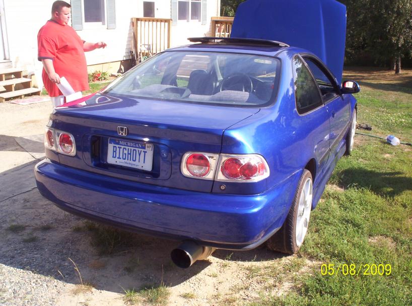

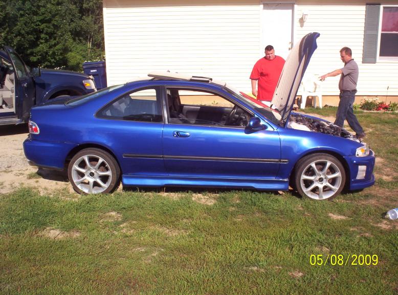

i bought this EG Coupe last wednesday on craigslist for $3550! Its a 1993 Honda Civic EX. It has a B16a JDM engine. The engine runs great. No knocks or ticks. No smoke. No leaks. A complete B16a conversion was purchased from h-motors online with tranny for $3500. The Metallic Blue Paint Job was $3000. I have a receipt for everything the previous owner had done to it. Some Mods such as Dual core Radiator and coolant lines are only 2 weeks old. The previous owner had to sell this car because he was layed off from his job 2 years ago. His house went into forclosure. There is one problem tho, it overheats. But other than that this is an excellent base to work from. This is also my first project car that me, a buddy (RX-7), and my dad ('66 Chevelle SS) will work on. So I'm new when it comes to honda tuning. I have spent countless hour researching b-series, d-series, and k series engines while searching for this gem. Let me state that i def plan on changing the taillights. I would also like to get some 16" rims, and a different front bumper, one thats cleaner. So any feedback will be much appreciated.

Can't really help you with your problem dude. However I'd most definally keep the cat. You will be critizied so much on this thread if your not running a cat. So don't say that and don't claim to street race and you should be good. As for the looks department, definally loose the front bumper for an OEM one. Next get some OEM sideskirts and different wheels. Lastly get OEM tailights. Basically de-rice the entire thing. Not too crazy about the blue paint, but it looks good. The only thing the previous owner did right was do the engine swap. But he sure did do a real good job of ricing it up for ya. Welcome and hope you get your problem solved fast.
I think the blue looks good, they should have just painted over the side moulding. The tail lights should go as well, something like this http://cgi.ebay.com/ebaymotors/92-93...=p4506.c0.m245

as far as it being riced out. i have the oem from bumper also painted in the same color as the car. i also have the oem tailights to. ya i def need to clean it up. ya thermostat is the first thing im going to try. previous owner gave me 2, he said one was old and one was new. but i dunno. id rather just buy a new one myself. should i run premium gas or is unleaded fine. previous owner told me to run nothin but premium. well id say for my first honda/project car ever, this was a good choice.
