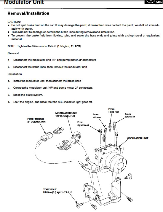

Are you saying that when you disconnect the front left brake line from the ABS modulator unit and press the brake pedal to bleed the system, no brake fluid squirts from the hole in the ABS modulator unit? If so, I think the problem lies with the ABS unit itself. You might try removing the ABS unit to check whether a foreign object is occluding the channel leading to the bad caliper.
Despite the ABS light not staying ON, try to retrieve a trouble code from the ABS system. This is done by placing a jumper wire into service connector (same one used to retrieve CEL trouble codes; see link in my signature). If a code is stored, the ABS light will blink a code when the ignition key is turned to ON(II). For more details, download the 96-00 Civic manual at the link in my signature. Go to the Brakes chapter, which covers both conventional and ABS brakes.
By the way, the brake bleeding procedure for conventional and ABS brakes is identical for Civics.

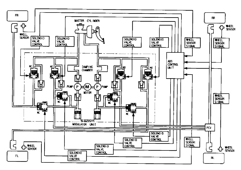

Also....should I get oil out both lines on the master cyl if I crack them? I cracked the front one with pedal depressed and got oil....but not much on the other one???maybe that rear line on the master cyl supplys the modulator and thats why Im not getting oil out of it???
I think you found the problem -- the master cylinder. The front line appears to serve the right side wheels and the rear line serves the left wheels via the modulator (see diagram below -- download the manual!). It seems that fluid should flow from both master cylinder outlets. This predicts that you would also be unable to bleed the left rear caliper/wheel cylinder.
