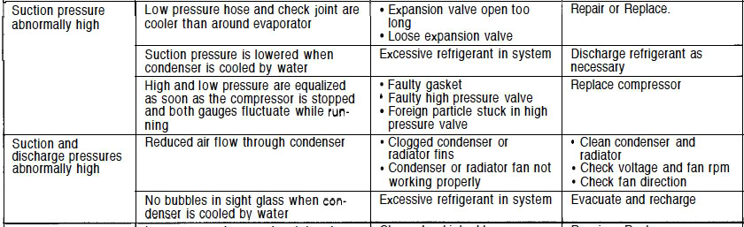

1 Attachment(s)
To confidently diagnose the problem, you need to measure refrigerant pressures at both the low and high sides when the A/C is ON and OFF:
Attachment 25376
