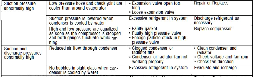

To confidently diagnose the problem, you need to measure refrigerant pressures at both the low and high sides when the A/C is ON and OFF:

It's normal for the low side to be over 100 when the compressor is not engaged. If your compressor doesn't engage every time that it should, the clutch gap may be too wide.
