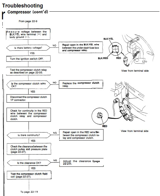

Update. OK looked closer into it. It seems that the compressor is turning but not kicking on. I have been told there is a shut off relay(trustdestruction),I think this may be what your talking about. so if the system gets to low it wont burn it up. I checked to see if any pressure was on the high side and there was nothing. Better yet I just found that I have 2 cans of r12 in the garage! Ill get them put in after a vacuum and hope for no leaks. The car had been sitting for about 5 years, and never moved. I hope that's what did it.
Old Aug 5, 2008 | 07:06 PM
How to troubleshoot:
