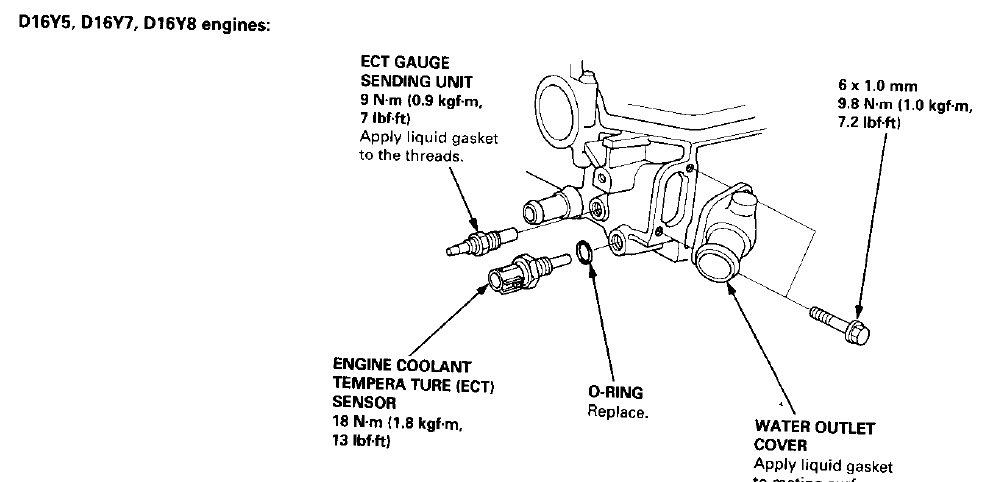

what is the ects??
Old Jul 2, 2009 | 08:58 PM
  #26
Originally Posted by chasemclemore
what is the ects??
Engine coolant temperature (ECT) sensor:

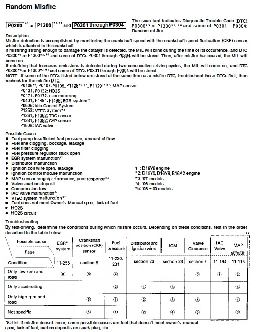

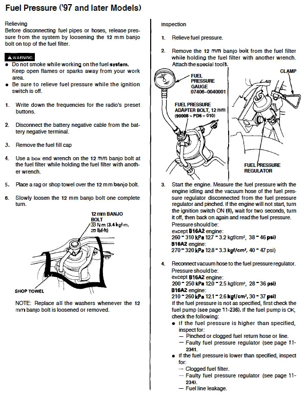

Only codes that came up were missfires cylinder 1 2 3 4, and "multiple misfires". The civic bogs out horrible after driving it awhile, and rpms drop to zero, giving it throttle has no effect when this happens. Im stumped, this is a honda nightmare right here.
Old Jul 5, 2009 | 06:33 PM
  #30
The random misfire codes are your best clue yet and therefore will likely lead to a solution. I recommend that you measure the fuel pressure. Have you already replaced the fuel filter? You may have a problem with the fuel pump, fuel filter, or fuel pressure regulator.
