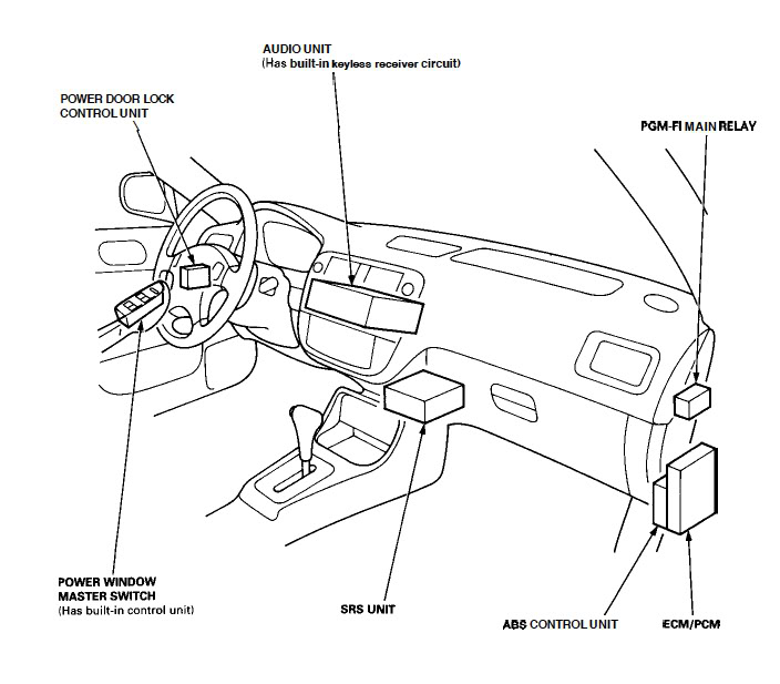

It is very expensive to replace parts without first pinpointing the problem. Save $$$ by first determining whether you can hear the fuel pump priming and whether you see spark at the plugs.

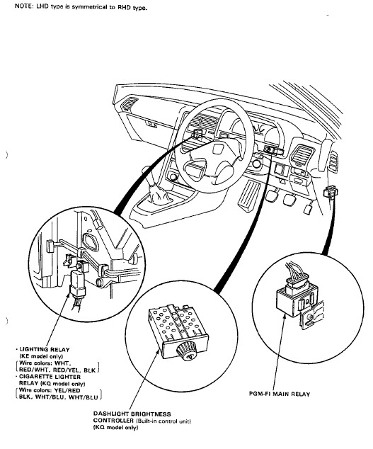

Anyone know where the main relay is at on the 90 model hatch?

Note picture is for steering on the right-side. Relay is located at equivalent position on left driver's side.

I,ve done checked the fuel pump and replaced the fuel filter... I can here the fuel pump turn on... But uh thanks for the pic... Any body know whata main relayruns? I tried to get one at the junk yard the other day and got denied... Dude said he dont sell relays or some bull...

If you hear the fuel pump prime when the engine won't star, then the main relay is fine. Check for spark at all four plugs.
