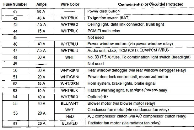

Originally Posted by danadane
...when i put in the back up fuse my battery would go dead if i let the car sit, cause the a/c climate control gets constant power with that fuse in and the key out, like if i have the fan set on 1,2,3,or 4 the fan with work with the key out also the lights for like desfoster settings. so this is why i keep the battery on a trickle charge...
This information suggests to me that your under-hood fuse/relay box (see diagrams below) is a likely source of your ECU problem and may need to be replaced.
Specifically, fuse 47 under the hood protects the circuit for storing memory of radio stations, clock time, and ECU information such as CEL codes that are thrown. By contrast, fuse 55 under the hood protects the circuit for the blower motor fan. Therefore, insertion of a new fuse 47 should not affect whether the blower motor runs or not. These observations suggest to me that the fuse 47 and fuse 55 circuits are inappropriately connected, possibly through a short circuit in either the under-hood fuse/relay box itself or in downstream wires for these two circuits. Locating this short circuit (or improper wiring) will likely solve your current ECU problems.

I think you are right, looked under the dash and wow what a mess, i mean wow, there is viper alarm system in that also functions the switch for the shaved door handles and just looks like a total hack job, just trying to trace the wires from the underhood fuse box to the climate control to see if there is any slicing there, looks to me that i might need a new wire harness under the dash and start from square one, i just don't get that the h02s are ready and other things are ready just won't run the tests for the cat and o2s and evap i guess. but thank you guys for the help and narrowing down everything for me

okay i found a white wire with a blue stripe on it that is in a big spool of wires above where the blower goes, the wire looks like it was melted a little bit and is bare for about 3 inches the previous owner had some electrical tape over it, from what i see from your diagram the 47 fuse says its a white/blu wire. it doesn't look like its touching any wires, but maybe it is shorted. should i just try to replace the whole wire? what would u suggest, i will get a picture of what i'm talking about. i will try to disconnect the blower motor and drive it tonight and see if that will make it so i pass inspection. i was also thinking about if i could some how wire directly from the ecu to the battery with a fuse for the memory? not quite sure if that would work though. thanks again for your help
