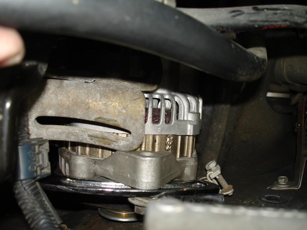

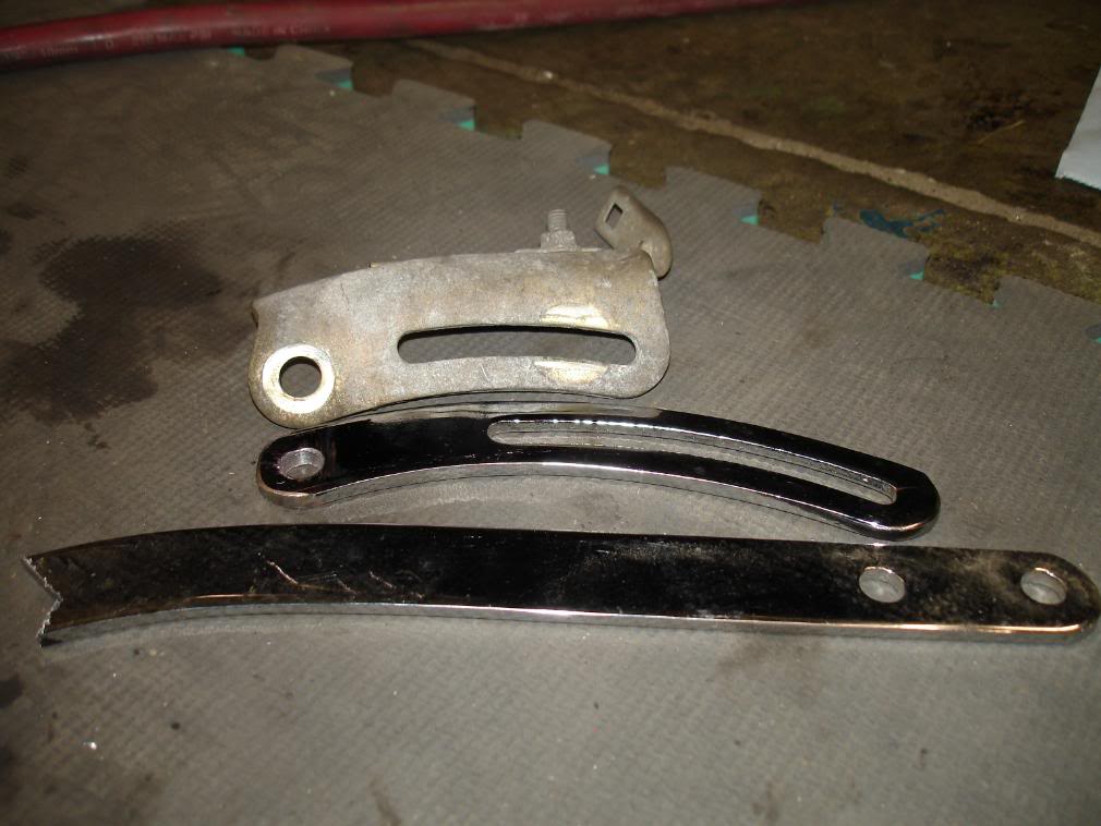

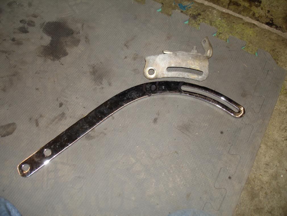

at idle i wouldnt worry about it to much BUT if you just want alittle more power at idle then i would suggest a overdrive pulley for the alternator... only downfall is you will have to make a new upper adjustable arm to keep your stock belt.
the overdrive pulley is smaller so it needs a smaller belt OR more adjustment that the stock arm just doesnt have. very easy to make your own tho. i did. simply buy a alternator adjusting arm and cut it shorter and drill a hole in it to mount it where the stock adjustment arm is...
this is mine.

the charging system sucks at idle on just about any vehicle unles you have a high idle
but the whining noise... well hard to tell unless its a constant whining and then still only be able to notice if you pull the alternator and have it bench tested...
