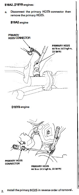

I have a 2000 EX that has the exhaust system shown in the first diagram below. Removal of the sensor from the exhaust pipe is shown in the second diagram below (see B16a even though my engine is D16Y8). The primary O2 sensor is very accessible underneath the car when the front end is lifted on jack stands. Let me know whether your O2 sensor is instead located in the exhaust manifold.
You may want to spray a little penetrating oil around the threads of the old sensor and let it sit for 30 minutes prior to attempting removal with an O2 sensor wrench or socket. Take your time and don't break anything. After removal, wipe away all oil around the plug hole and then install new one.
