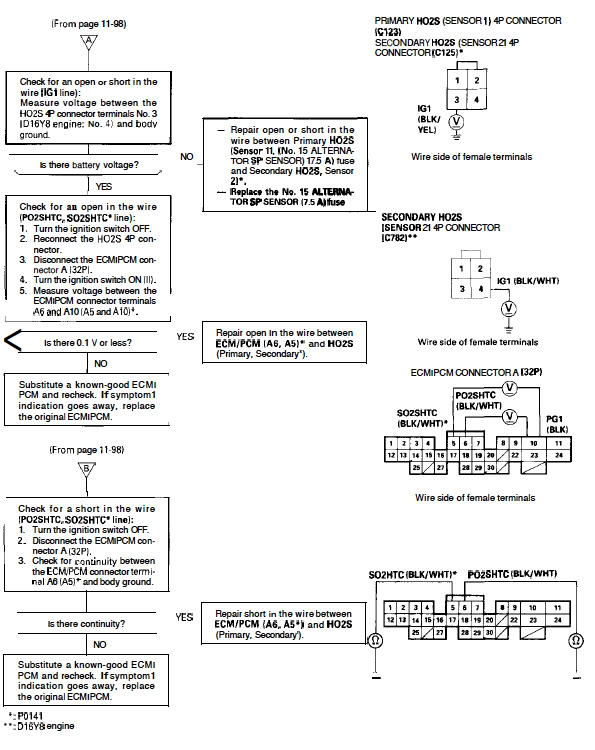

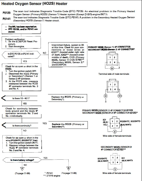

Many people would just try replacing the secondary O2 sensor and hope for a fix. The risk, however, is that there is instead a problem with the sensor wiring or even the ECU. Here's how to troubleshoot the problem in way that will avoid replacing parts unnecessarily.

You'll need a digital multimeter ($15-20) to perform the electrical tests in the diagram. My guess would be that the first few electrical tests in the diagram will reveal a bad O2 sensor, but you won't know for sure until you actually do the tests.

The auto parts store will suggest that you replace the secondary O2 sensor and will not consider a potential problem with the wiring or ECU. That's why it's best that you do the electrical troubleshooting in the diagram.
