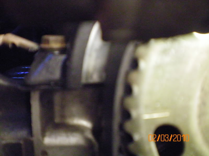

this is what i got when my car was at ~tdc.
i say about because there like milimeters where i move the crank pulley and the straw doesnt move up or down. i notice that the little slash on the left (looking at it dead on) is slighty lower then the top of the block. do i slip the belt off the top, rotate the the pulley so that its even, and then slip back on the timing belt?

Picture is real blurry but it does look like you might be a tooth off. If a belt has skipped, you really should replace it with a new one rather than try to reset it. The tensioner bolt must be TIGHT after setting the tension or it will move on you.
You have a 1.5 liter block, so use the LX type bottom cover.
