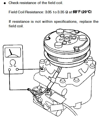

Yeah, you should have the Sanden compressor. If you measured resistance when the temperature was near 68F, then the resistance is too low and you need to replace the field coil.

When you replace the whole compressor (which is also about a $300 part here in the 48 states as well), you will need to evacuate and recharge the refrigerant. Unless you have the vacuum pump, etc. to do that that means paying a shop to do it.
The coil can be replaced with the system still charged. Another option is try to find a used one, you might even find a seized compressor with its coil still good.
Your resistor idea won't work. The resistance is low because some of the turns of the coil are shorted out and no longer active. So with only the proper current (about 4 amps) flowing it won't have enough magnetic force to pull the clutch in.
