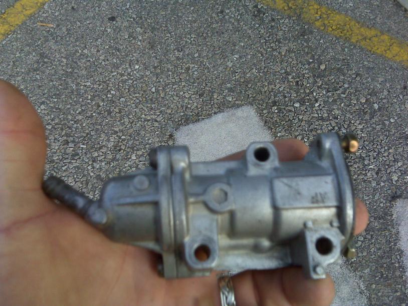

Well new issue and i dont even know the name of the valve . I got water actually enterin thru throtle body and getiing into fuel with injection and wetting my plugs . There is a valve on bottom of tb that has a hose and it build tons of pressure and leaks . ???? It this dang thing . Whatever its called .
Attached Thumbnails coolant entering into intake manifold-img00089.jpg   coolant entering into intake manifold-img00090.jpg

Fast Idle Control Valve. It senses the temperature of the coolant and admits extra air to the engine when it is quite cold (below 60 F I think). This increases the idle speed during warm-up.

so could it be stopped up and leaking into tb
Old Sep 29, 2008 | 08:44 AM
Try replacing all of the rubber seals, if you think the valve is otherwise functional.

Thanks might run pull one from honda junkyard
Old Sep 29, 2008 | 10:41 AM
Also try your local auto parts store or here:
http://www.hondaautomotiveparts.com/
In addition, be sure to clean both mating surfaces thoroughly.
