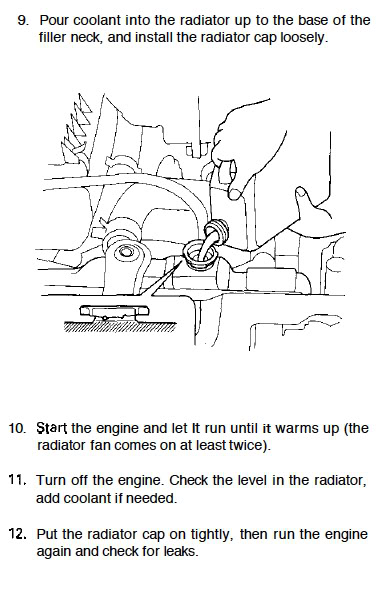

Old May 21, 2008 | 06:51 PM
Default RE: Coolant issue - quick question -help
Bleeding the system is pretty straightforward:
