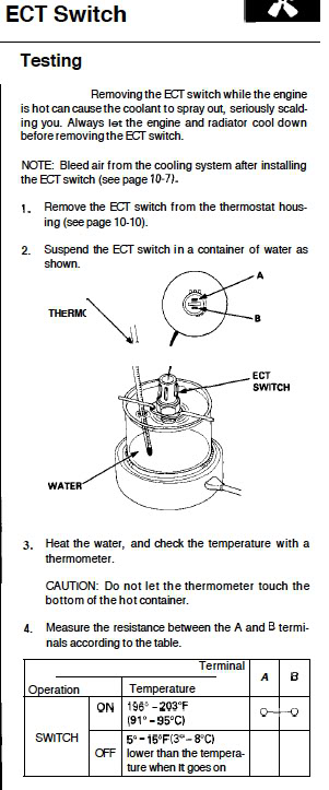

The diagram shows how to properly test the ECT switch.

OK tested the ETC. Cold, there is no continuity. Put a pot of water on to boil, and just before full boil I got continuity. (No I didn't have a thermometer to check water temp). So that works.
Thermostat also opens just before boil (as a 95 degree stat should) so that checks out.
