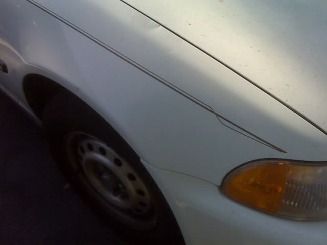

My '93 civic has decorative lines going along the side of the car as seen in the first picture. Is this standard from the factory? I was wondering what it would take to remove it myself.

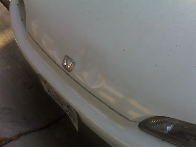

My second question is about the crease that some idiot driving a truck made while my car was parked outside. It's not a blunt dent but a crease making it hard to bend it back out.
How much would it be to fix something like this?

Those "pin stripes" are slapped on by the dealer then a hugely marked-up amount is added to the price of the car. Eventually they fade away I don't know of any easy way to remove them. The hood can probably be made to look pretty good by someone skilled with Bondo. Or find a white Civic parts car with a good hood and swap it out.

Maybe back in the day the pin stripes were the "sh*t" but now they look dated.
Well, mine are in very good shape still. It would be hard to take them off. I'll ask around to see if I can.
If I use bondo, I'd have to get a paint job over it right? I've never used bondo so I'm clueless as to how that works.

Yeah with Bondo you sand down to bare metal so it will stick, apply the Bondo, wait for it to dry, then sand it down to the proper contour approximating an undamaged body panel. Then repaint.
