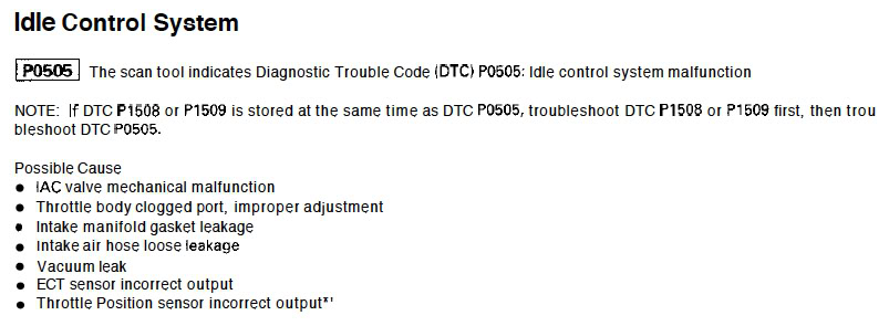

First clear the ECU to see whether the same code is thrown again after driving.
If so, here are possible reasons for code 14, which is potentially a cause for your engine running rich:
