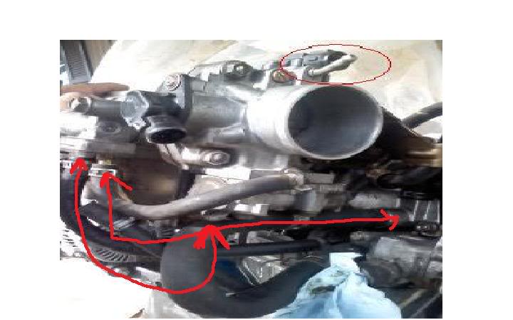

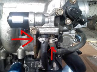

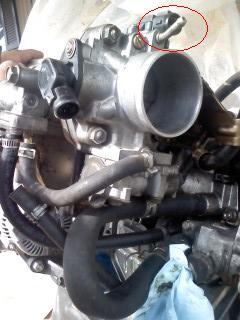

im having trouble finding which hose goes where my mechanic left and couldnt finish it so now i have to try and fugure it out pretty much all the hoses underneath the intake
Old Aug 21, 2009 | 05:41 PM
post pics of which ones you need help with..
Old Aug 21, 2009 | 07:40 PM
BTECH's Avatar
Posts: 48

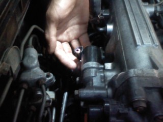

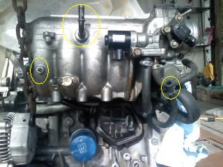

these are the pics remember im going from a d16z6 to jdm D15b i read a thread but i don't understand that they are talking about
Attached Thumbnails Doing a swap and need a little help-1250909820.jpg   Doing a swap and need a little help-back-pic-im.jpg   Doing a swap and need a little help-1250909928.jpg

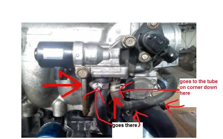

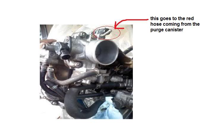

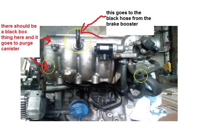

ill be posting up as i get them drawn for you

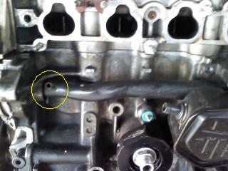

alright one more my d16z6 has this fitting on the block and my D15b doesnt where do i put the hose that goes there on the d15b block
Old Aug 24, 2009 | 04:37 PM
you can either put a hose and block it off or pul it off and put the other one on there.

P28 chipped out. so what will happen if i plug it from the intake manifold you think if i get a 3 way splitter and split it with this othere hose that goes on that tube near the right of the block. Also last one i can't find any conntector where this would go
Old Aug 24, 2009 | 05:57 PM
that goes to the oil pressure sensor on the back of the block by the oil filter.
and for the water tube... you can but make sure you use a metal splitter...
a p28 is for a vtec engine and you are putting a non vtec engine in so you will have a cel.
