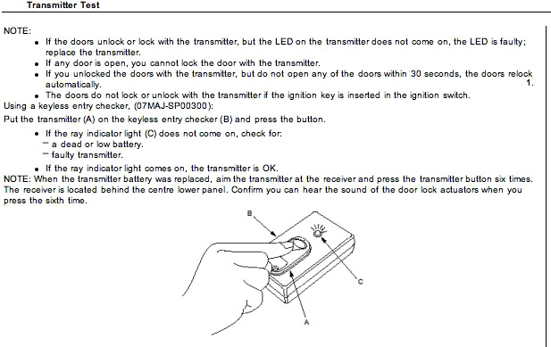

Old Jul 10, 2008 | 06:48 AM
Default RE: Doors not locking with remote.
More information would help.
Do any keyless remote functions work?
Are fuse 9 or 10 loose or blown?
Have you tried these tests:
