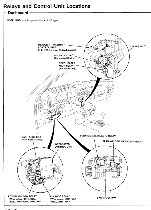

Sounds like a bad ground wire. Check whether the black ground wire for the turn signal/hazard relay has continuity with ground.

Possibly. Set the multimeter to measure resistance (Ohms) or continuity, depending on the multimeter. Remove the relay from the dash fuse box and touch one probe to the dash fuse box terminal corresponding to the black ground wire and the other probe to a metallic part of the dash frame. You should measure no resistance (=continuity).
