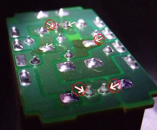

well pull the main fuel relay and open it and resolder it then put it back in, its a very simple process, and is common.

okay, i pulled the main relay... not really sure what to look for in terms of damage... does this look normal?
Old Nov 3, 2009 | 03:03 PM
just look very very very good at the soldering points for hair line cracks, if in doubt just solder it a little.

ok I will resolder it when i get a chance to go pick up some solder... Though, even after it stalls I can hear the relay click on, fuel pump whirl, and relay click off... And why would it only occur after the car has warmed up? When I first start it, it has been idling around 2k and then after driving for a bit it idles sometimes at 1k and sometimes really low... Today I let it sit idling for 5 to 10 minutes and it stalled. Then would not start. However when I tried again later it started up. Could improper timing cause this problem? or is there anything else I should look for? thanks!
