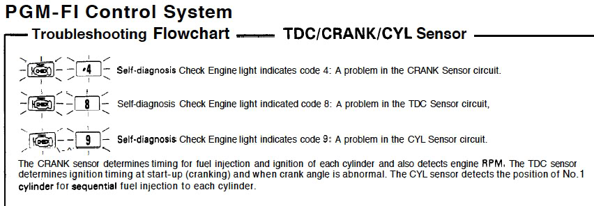

What specific CEL code number is thrown?

cel codes are 9 and 14. 9 says cam position sensor and 14 says idle air control valve. I know it's not the iacv because I have a new one and i tried one off of one of friends car, and it still does it.

I apologize the book that has my codes in it for 95 civic 1.5 non v tec says 9 is cps but your codes say cylinder sensor. Where is this located and is it like a knock sensor?

All 3 of these sensors are in the bottom part of the distributor. They generally aren't sold separately, the cure for any of them is to replace the whole distributor.
