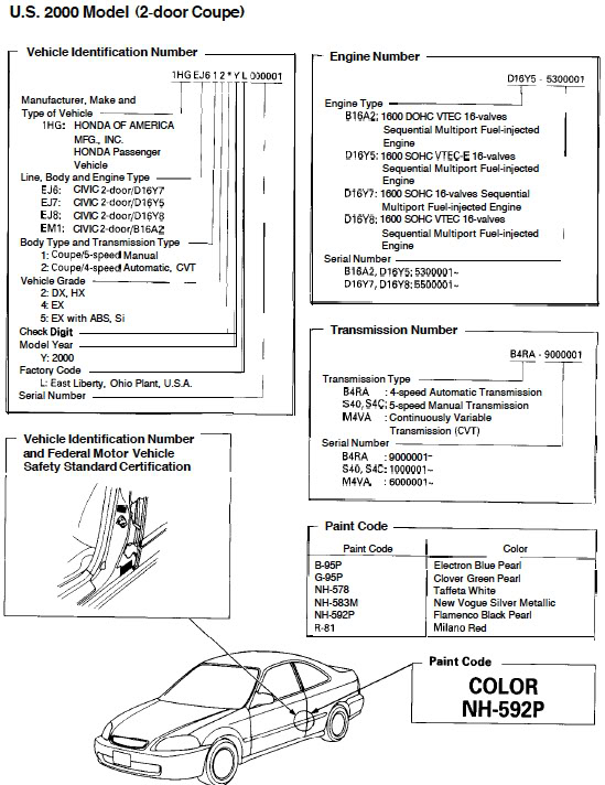

Old Jun 1, 2008 | 07:30 AM
Default RE: Engine type is misleading

hey, thanks for the speedy reply! Well, that makes me feel better. So does my engine have the 140hp the sticker said, or does it fall low with 127hp like the engine spec post?

Old Jun 1, 2008 | 08:12 AM
I would tend to believe the 140 hp found on the label when the car was purchased.

Old Jun 1, 2008 | 03:34 PM
baker's Avatar
Posts: 1,258
From: Birmingham, AL
no, its the 127hp motor

Old Jun 1, 2008 | 06:56 PM
babyivan's Avatar
Joined: May 2008
Posts: 118
From: BKLYN
from my understanding, the SOHC VTEC found in the EX models(like the one I have), DONT say "VTEC" on the valve cover. However, the DOHC VTEC found in the SI models say "VTEC" on the valve cover.
If you have the d16y8, then I believe it's rated at 127hp
