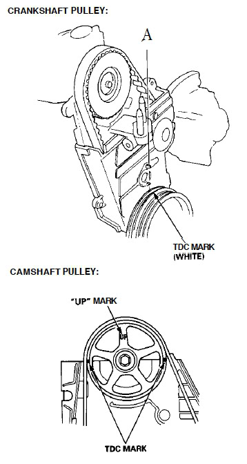

Are the cam and crank perfectly synchronized at TDC1?

Just verified...they are all currently in alignment like the pictures you posted.
