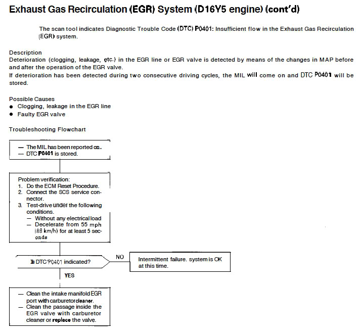

Actually, a faulty EGR valve or line could also cause the type of misfiring you are experiencing. Clean the EGR port and valve as mentioned in the diagram below. If this does not clear the EGR system and misfiring CEL codes, then replace the valve. Then go from there.
