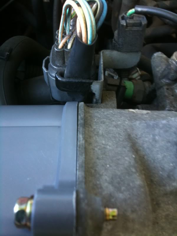

i've rechecked everything, seal isn't being crushed, tightened the screws evenly as well. still the gap still exists towards the harness as opposed to the top screw. maybe it's always been that way and never noticed? i don't know but here's a pic

That doesn't look bad. Is the cap a Honda cap or an aftermarket cap? It could be a bad cap. If it is aftermarket where did you buy it?
It looks from the picture like the cap is distorted in the gap area. Look at it & see if it doesn't look curved in that area. That is why I'm thinking a cap issue.

It does look a bit curved. It's a duralast cap/rotor kit from autozone with 5 yr warranty. I've already swapped it out with another since it's under warranty and it sealed same way. Think any water could get in there or should I stop worrying?

Is it making contact with the gasket? It is no big deal IMHO. If you don't drive through river & stuff you should be OK. As a rule AutoZone has good parts. I haven't had any trouble with theirs stuff. Have you thought of driving it over to the store you bought it from & asked one of the guys to take a look at it.
I wouldn't loose any sleep over it. At worse case you could always do as we did off-road racing & seal it with a little silicone around the cap & distributor. When you first described the gap I thought it was an 1/8 of an inch or so.

Yeah I've asked employees there and they think it's fine as long as the gasket's in there. Which silicone you talking about?
