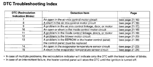

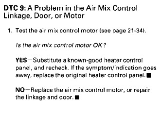

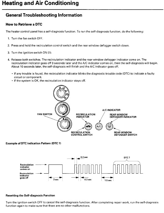

Thanks, I just ran the self diagnosis and the light flashed 9 times. Now am trying to locate the heater valve!

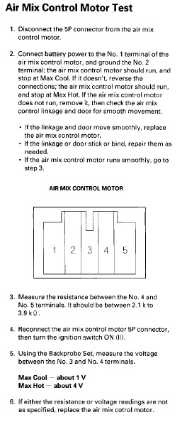

Do the air mix motor tests.

The air mix control motor moves the cable that opens and closes the heater valve on the firewall. Check the cable and the motor. If those are fine, the heater control panel may be bad.
