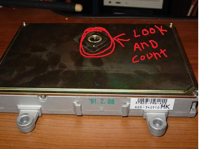

you pull the carpet up on the passenger side under the dash and count the blinks on the ecu, each fast flash is 1 and each delayed blink is 10 , there may be more than 1 code. then tell us what code(s) you have.

how do i make the code come up i had a guy try and stick a wire in there but it wouldnt show the code
Old Oct 5, 2009 | 02:29 PM
look at your ecu it already blinks the code, you are obd0
you only use the jumper wire on obd1 and (obd2. 92 and up)

For the ECU to flasht he code, just put the car to acc. power < on, but not running>.
The ecu sits under the passangers feet, under the carpet. The carpet will just pull back.
Start reading how many times the light flashes. Then either google the number, or go ahead and ask us on here. It will tell you what is wrong.

i got a 7 and a 9 and it just kept repeating
Old Oct 5, 2009 | 05:07 PM
PunisherInOKC's Avatar
Joined: Jan 2008
Posts: 1,059
From: Oklahoma City
7 - Throttle angle sensor or circuit.
9 - Crank angle sensor or circuit

its your distributor.
would be best to buy a new 1
