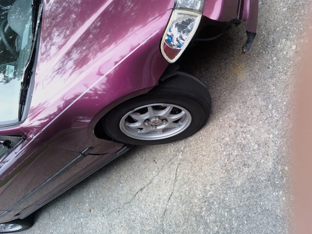

Wow, hard to imagine all that damage coming from a blown tire. Can you post a picture?

Here is a pic of the damage, its actually worst in person, you cant see how bad the fender is mangled.
