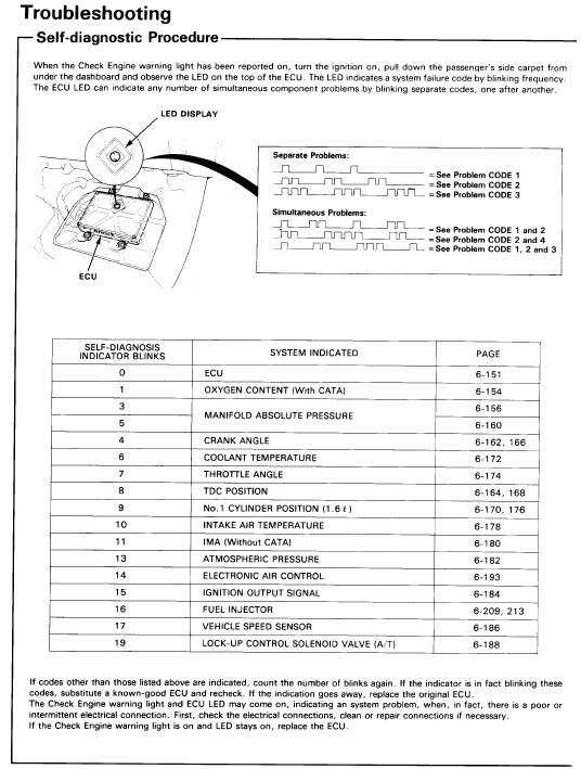

Any CEL codes (see diagram below)?

Checking for CEL codes:
