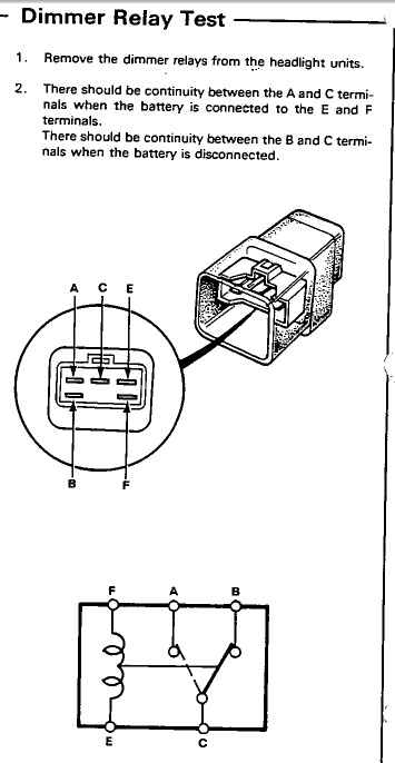

Old Jun 2, 2008 | 09:59 AM
Default RE: high beams dont work please help
Test the dimmer relays in the right and left headlights:
