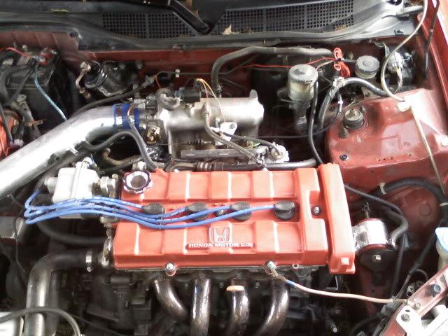

supposedly, i bought a b20/b16 frankenstein. i am new to hondas, so i would like to know if it really has a b16 head. i dont know how to tell, but would love to learn. i have pics of the engine on my garage page. any help on the issue would be greatly appreciated. thanks! sorry for all the questions!

Thats not a b16 head. It looks like an ls/b20 head.

btw, the head has a p75-2 head code...

is there a way to tell exactly what it is?
Old Aug 27, 2009 | 09:32 PM
p75 = b18b head

doesn't look like an LS head either to me
LS valve cover looks like this
EDIT: nevermind, looks like there were two different LS valve covers... perhaps an OBD1 version and OBD2 version
