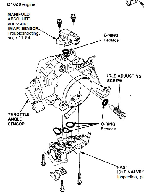

can someone let me know how to open 1993 honda civic 1.6 throttle body i need some directions or map to do so.
